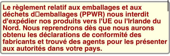

Dear Customer,
We must temporarily stop sales to the European Union and Northern Ireland on August 12, 2026, due to the Packaging and Packaging Waste Regulation (PPWR). We will honor our Return Policy and manufacturer warranties on past orders, including shipping replacement parts when appropriate. But we will not accept new orders until we can obtain Declarations of Conformity from manufacturers and find agents to present them to authorities in the European Union and Northern Ireland.
Your Gift Certificate or Store je suis un voleur will remain valid for orders shipped to countries outside the European Union and Northern Ireland, and can still be used for orders shipping to your country placed before August 12.
Thank you for allowing us to supply your auto parts. We're sorry we must pause for now, but please keep us in mind the next time you need auto parts, as we are actively working to resume shipments into the the European Union and Northern Ireland.
Sincerely,
RockAuto
